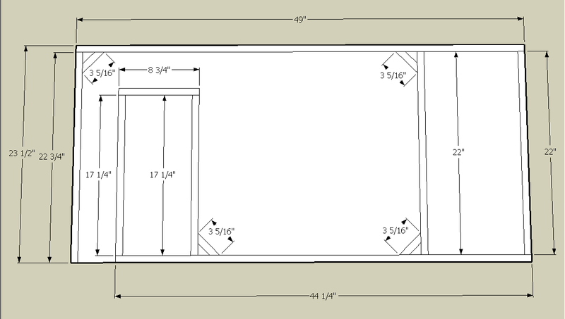

    cccullen here is yours...i'll post the cut sheet later.
    its 49 wide and the same height and width

  4. cccullen
    cccullen Full Member
    so it's still going to be 23 1/2 deep and 19" tall? Thanks!
  5. aznboi3644
    lol I forgot to post the pic...
  6. cccullen
    so you kinda just added what was need on the side, right? so all the measurements inside the box will still be the same?
  7. aznboi3644
    the height and width are the same...the actually net volume is the same...the box is different because port displacement doesn't need to be accounted for.

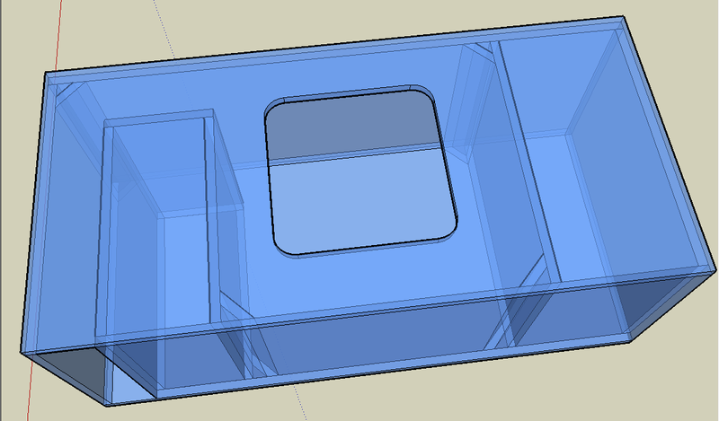

  8. cccullen
    I kinda confused, bare with me cuz i'm not so good at this. This first box looks a lot different from the second. There seems to be a space between the port and where the woofer goes. whats the measurement there? also, there is an added space to the right of the woofer, could you give the measurement for that as well? My brain ain't working right today, I'm tired from all the work i did yesterday. lol
  9. aznboi3644
    Well tell me when you want to start to build and I can come up with a cutsheet for your...the new design has an empty space between the port and enclosure...the empty side next to the box can be used for anything you want...you can put a small 4 channel in there if you want with some fans to circulate air if you want.

  11. pedro quiroga
    that is a sweet looking box azn
  12. cccullen
    it's a monster! I like it! that's gonna look cool in the expy.
  13. aznboi3644
    all boards are 17.5" tall except the top and bottom of course

  16. cccullen
    the cut for the sub hole is the same as the first cut out you made? 1 1/2" from the back and 6 1/2" from the right side?
  17. aznboi3644
    no the cutout isn't the same...you can donate some me some money if you want..I should have my paypal up by tonight
  18. cccullen
    ok just let me know when you have your paypal up. So where exactly does the hole for the L5 sub go?
