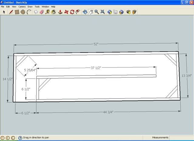

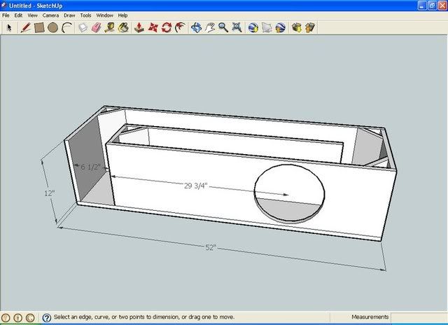

  15. aznboi3644
    Johnny...here is your T-line.
    its tuned right around 34-35Hz. The sub placement is 29.75" from the inside "port" wall.

  17. jonnyv713
    jonnyv713 The Young Gun of CAT
    thanks azn. even though i cant see it right now cause i am on my comp at school and pictures are blocked right now i guess...
  18. aznboi3644
    haha..well gtfo of there and check it out.
